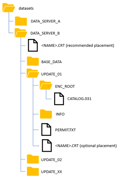

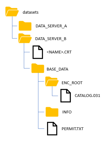

Schema Administrator (SA) Digital Certificate
If you require an additional or alternative <NAME>.CRT file to the IHO.CRT file for your data, it is recommended that you place the <NAME>.CRT file in the data's parent folder in the datasets folder. Alternatively, you can put the <NAME>.CRT file at the same level as the PERMIT.TXT file for that data. Both the PERMIT.TXT and <NAME>.CRT files only decrypt datasets at that level and downward in the folder structure. If you own the data, it is recommended that you divide your data in the datasets folder at the top level by the <NAME>.CRT file being used, as well as the data server.
NAME.CRT file location
Datasets folder structure
Note:
The same USER_PERMIT.TXT file must be provided to each data supplier being used for the system even if they are encrypting data against different Schema Administrators. Any name can be used for the alternative <NAME>.CRT file as long as the file extension is .CRT.

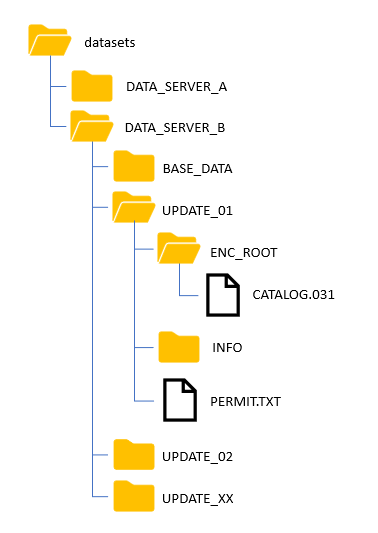

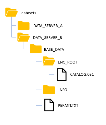

PERMIT.TXT location for base load
PERMIT.TXT location for update load
